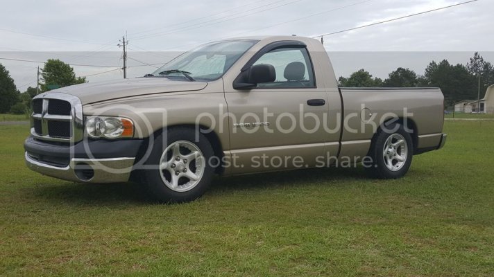

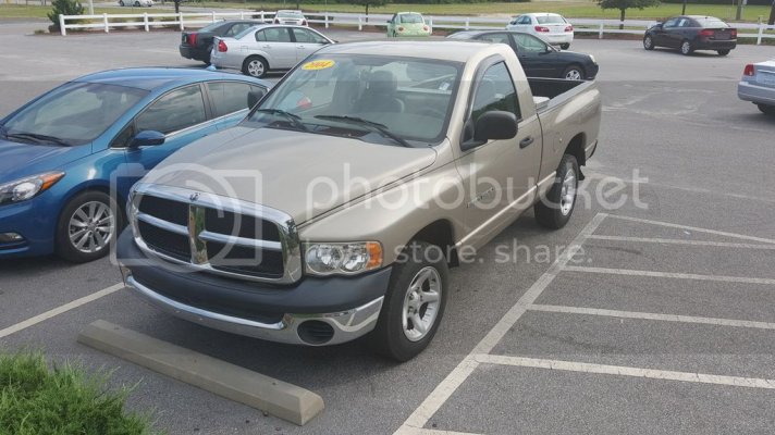

Here's the before:
Here's how she sits right now:
Plenty of work left to do, but she should look great and ride like a dream when finished.

Nice! Very nice stance as she sits. What other stuff do you plan on doing?

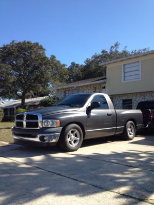

Looks good. An familiar lol

Do those rims not have issues when lowering, with the lower ball joints? Looks pretty legit to me.

You have to cut the lower ball joint down to the bottom of the castle part of the nut and they clear. I was a bit nervous about cutting that much off, but after doing the research and running into people who have had it done for 200k miles, it eased my mind a bit. I will admit that I used Loctite very liberally on that nut though.
Once I get my 22's, I will replace the ball joints again anyway.
