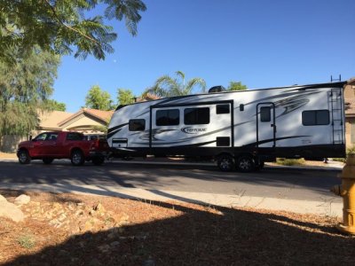

You want to tow a fifth wheel. Get the 6.4 heavy duty with a long bed.
I wanted to tow heavy, so I chose a diesel and and a 36' TT.
