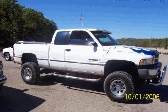

I have a 5" Tuff Country EZ-Ride lift on my truck with 35"s. The lift itslef is nice, the truck rides fairly smooth for bein lifted and all. As for tire clearance, they only rub if i hit a bump with the wheel turned but its nothing major. I love it how it is though!
