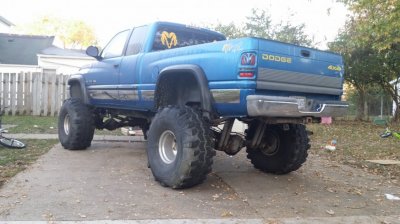

So after checking out some vids of what axle wrap is....I kinda doubt my truck would be doing anything like that...only Bc I have these long ass I'm assuming their called control arms that run from the frame down to the bottom of the rear axle.

Best pic I have of the ass lol

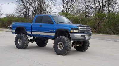

More pics

I'd start with those bushings you mentioned. I would imagine they're either tough country like you mentioned or Fabtech. Only other companies that make any for us are bds and dodgeoffroad and those aren't them lol.
If the wobble persists i would probably do a tire rotation. Left on right and right on left. See if the problem follows
