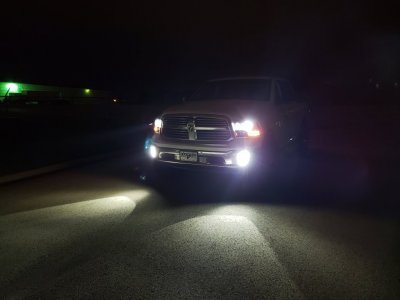

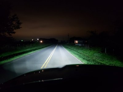

If you have projectors, avoid LED. They just do not work well. Hotspot fades and you lose distance vision. If you live in a big city and do all of your night driving under street lights, you might be ok, otherwise, go HID for projectors.
I can’t comment on reflectors, but hear some of the LEDs work quite well in reflectors. The chip size looks ok, can’t verify placement or thickness. Those 3 factors will be the biggest determining factor for beam pattern. The idea is to have the chipset match, or be as close as possible to, filament size and placement on the halogen bulb of that size.
In the picture posted above, notice how bright it is directly in front of the truck, but how quickly it fades out. Driving 60 mph, you’re basically blind to anything that will be a hazard faster than you can react
Makes sense thank you! I have reflectors so I should be alright here. I have heard amazing reviews and the low beams on my OEM are super dim (surprised they are legal honestly)
