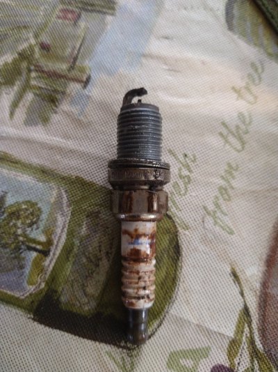

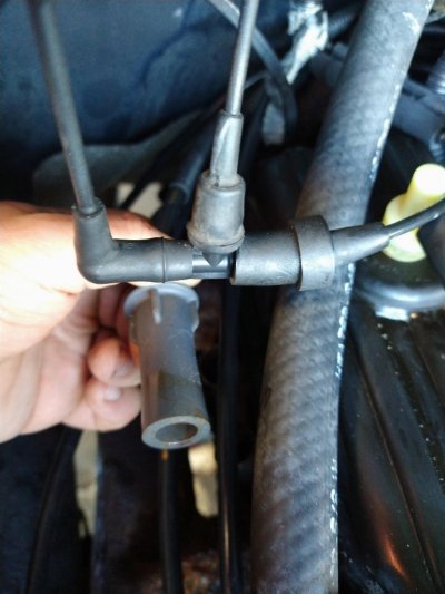

No when I took the spark plug out the spark plug was dripping a lot of water off of it and then the boot the spark plug boot literally I poured water out of the end of the spark plug boot but no water is coming out of the cylinder though but that's a lot of water brother
Sent from my moto g stylus using Tapatalk
You think it's definitely the head gasket right not the manifold right. I guess it's a lot cheaper just to get the heads and have them put in then having head gaskets put in go figurefaa07a528ca015166af1d2c517d10074.jpg

This is the driver side which isn't as bad the passenger side right now is way worse than the driver's side so I would say that's the side with a blown head gasket I'm about to just order the the remanufactured heads right now and then the gasket kit set that's it I need a timing cover you said toc60f12b26ab8c5c06a352fdfd82644fe.jpg

Do your pressure test before buying parts. Otherwise you’re just throwing money at it and aren’t sure it’ll fix it. Second best bet is tear it down and you’ll find out as you tear it down where everything is getting wet from. Given its external water most likely not heads or head gasket but always a chance. Honestly I’m stumped but the pressure test will hopefully help. Either you will see water come out or hear air

Yeah but when I took out the spark plugs this morning the driving side heads will fine you just wear the boots click in that was like that brown sludgy water you see the passenger side man everything was soaked dripping water even the spark plug boots I was pouring water out of some of them so it's got to be the head gasket is blown on that side man it was the last thing I wanted to f****** find out.I still want to do the depression test first but then I just found out from Amazon it's not even coming today like it was supposed to but yeah I definitely want to do the pressure test first but I know it's the passenger side man I could just tell by doing that

It is possible the head gaskets are just blown externally and not internally - rare but possible if it was over heated.
Are you positive that you aren't getting water on the plugs when you pull them out? If the little recess externally is full of water then water would get on the plug tips and threads when pulling them out.

L I just want to do the radiator in the radiator cap pressure test to see what's what's going on okay go from there Amazon's killing me man They're killing me. I took the plugs out and I soak them all and gasoline made them brand new to come look at all that rust color off but out of the eight spark plugs six the perfect like they just came out of the box now after soaking them in gas and two they have a little burnt Mark way hotter than the other ones did on the firing point up above cuz it's a twin tip

I have a hard time following all you are saying, Sounds like the water pump may be spitting water out the shaft if you have water on the plug wires.
I would drain the antifreeze out, the block as well, Than with the plugs all out , spin the starter over for a few turns, to clear the cylinders out, use a remote starter switch and watch for water coming out the plug holes, if so , pull the heads.
