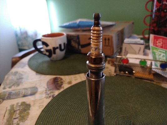

I'm taking my old spark plugs out now soaked with water I mean it's pouring out of certain spark plug the wires the boot hey I'll show you one not to boot this Rock club064f20253ce1bf0d2b5495f0decce917.jpg6ecef894f855d63cf585ee72bb7a9e43.jpg092334a1f1b97d86fffa6c437374ff98.jpg9b060bc09d9edbb2594e634b24326611.jpg

Dan98
Dec 13, 2019
210
50
Michigan
1998
5.2
Poring out of cylinder trough spark plug holes
Sent from my SM-J260A using Tapatalk

U should probably not waist time trying to start it just take it apart to fix it

No when I took the spark plug out the spark plug was dripping a lot of water off of it and then the boot the spark plug boot literally I poured water out of the end of the spark plug boot but no water is coming out of the cylinder though but that's a lot of water brother

Coolant is only from outside of engine
