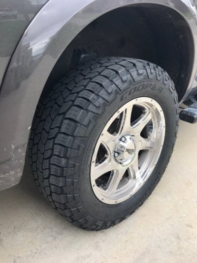

just put the cooper AT3 XLT tires on my 2016 Ram 2500....perfect.
I highly recommend them ....go check them out

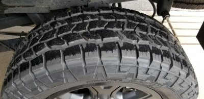

I've been waiting for Cooper to come out with something that has sidebiters! I've seen them but not on a truck. What size did you go with? I have 275/65/20 on mine now.

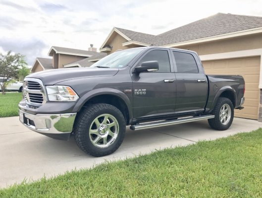

I’ll be getting mine delivered tomorrow and installed on Monday after bilsteins! Will upload a pic!
Here are the specs of what’s coming soon:
Cooper At3 XLT 295/60r20 with bils set to 2.8 and 1.5” rear spacer...

Just got mine delivered! Monday cannot come soon enough..
Also, just a heads up.. I ordered from tiresshipped2you.com and they were $301.99 ea with Free Ship and No Tax to Texas! Again, 295/60r20

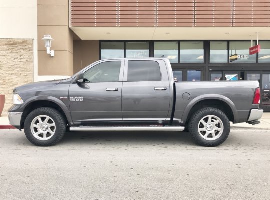

Can you tell me the specs on your truck please ?
Lift, wheel size/width/offset
Thanks
2016 Lonestar 4x4
Bilstein 5100s all 4
Front set at 2.8
Rear 1.5” summit performance spacer
Mevotech UCAs
Airlift1000HD
Wheels are 20x9 +18mm and tires are 295/60r20 which is 34.1 x 11.6 on this wheel.

would the 295's fit without any shock work on my stock 20" rims?
They’ll definitely fit on stock rims. My wheels are exact factory size and offset (20x9 +18mm)
If you have air suspension, they’ll probably fit without a lift or shock replacement..
Honestly, stock no level or shock swap, and no air suspension... they’d be very close to fitting.. but to be “safe” I’d say no..
Bilsteins are like $110 a shock, so let’s say $240ish plus install and alignment.. you could honestly be in some Bilsteins for under $600 and the ride quality would be extremely improved over the factory mopars.
Or, you could always throw a quick 2” Spacer and upgrade to Bils later.. but, a 295/60r20 probably shouldn’t be run at stock height.
