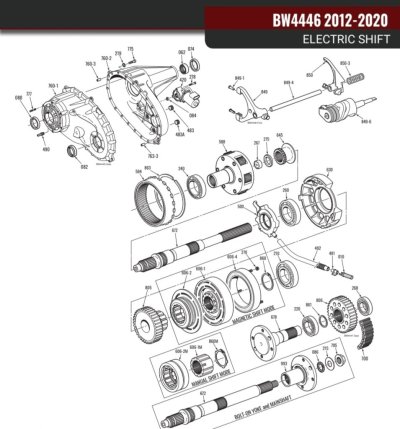

Ive Been looking for bw 44-44 because that's what my Manuel says to use on our 2020 ram 3500 hohd. So after doing all my online research I found the part number ( 68089195aa) for the mopar , bw44-44 so I type that in and find advertisers showing pictures of 5 different oils with that same item #. One for
44-44, another for 40-44, another for 40-40, another for 40-45 40-46 40-47 & pre 2016 40-44, so which one am I supposed to use, wtfo? So im like screw it ill call the dealership because there price can't really be any worse then the online prices of $50-$68 per quart. The parts guy says ok let me look up your vin, then he says that you have a 44-46 tc so you'll use the
44-44 & 44-45 oil ( which I've not seen advertised yet) which we have on hand. I said wait a minute because my owners Manuel says to use 44-44 but your telling me I've got a 44-46 tc that's calling for 44-44 & 44-45 oil only and he says not to confuse the 44-46 tc with the needing the same fluid type, and i ask how does he explain my owners Manuel calling for 44-44 which he doesn't have any answer for. Plus he won't give me the part number for this mystery 44-44 & 44-45 only oil, damn stealerships . I'm even more lost know then when i started off, I wanted to use a mopar only fluid on this first service while it's still under warranty and then ill probably switch to all ravenol at the 60k mark once it's out of warranty.

They're basically the same t cases except the 46 is basically just bigger.
Nice pics.
What I can't make any sense of is that if its in fact a model
Bw 44-46 tc then why does the owners Manuel call for
Bw 44-44 oil? Any ideas or proof on that one because I just want to be more sure in getting the right stuff and not just what a parts tech told me.

I get what youre saying. Amsoil reccomends atf. And there is no way on God's green earth you'd have a 44-44 behind a cummins in a 3500 it'd never last with that torque.
The mopar Is for the 45-46-47 cases.
My guess is it's all the same because why spend lots of money on a bunch of different fluids when you can use specialty trans fluid and sell it as oem for $50 a qt lol
Been running atf in my 44 for years and Havnt even had a hiccup. $35 for a gallon of good atf and you're good for a couple oil changes. Seeing as the 46 doesn't have any clutches there's no real worry on burning it up, just need enough to keep the planetary and the upper bearings lubed. I'd trust amsoil after all it's their business haha.
