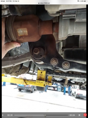

Bearings are tricky, you think they coming from One side, then you find out it’s the other side that’s gone! Plus sometimes, they don’t have any play in them and they still toast. I found this out as well. I use to be hard on the truck and went through 4 front wheel bearings (2 each side). Each time a different symptom. Go figure!
