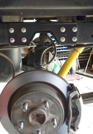

Spent the morning at the shop. I'm happy with the results.
URL=https://imageshack.com/i/nazpinj]zpin.jpg[/URL]

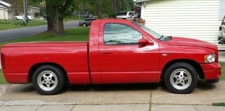

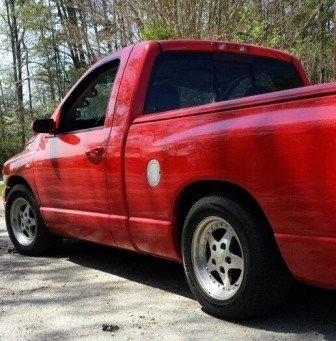

Installed the OEM shackles, probably dropped another inch or so. The old girl is really dirty from the pollen. sorry..
Keep in mind the tires are 28" tall

Went back and cut a pair of 3/8" plates for the back of the frame and welded it all together. It's plenty strong. Spent the afternoon waiting on the freight truck to arrive with the hood. Finally called and was told the truck broke down. All BS to me.... Maybe tomorrow.

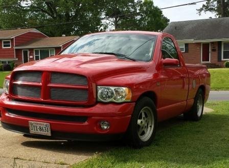

Here it is with the hood on.
