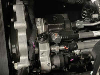

I can tell you all for sure that the 2021 high pressure fuel pumps are SIGNIFICANTLY different than the CP4 or CP4.2. I believe Ram went back to using the CP3. I have attached two photos, one is a 2020 in a 2500, the other is a 2021 in a 3500. Both are standard output Cummins. I found an article a while back that had Ram confirming a HPFP switch, but no official word that it is the CP3. Personally, I believe it is the CP3, and they found their mistake within the two year window.

I know people have said that cp3 on the new 2021 will not retro fit on the 2020amd 2019 but it looks like it will... Hopefully they are wrong

It's right there in color (pictures). Have seen dozens of pictures and videos from new 2021 trucks, they have CP3's.

It's a cp3. I know what I am looking at.
Now if you want to be a conspiracy theorist I suppose some one could have spent a ton of money to disguise a cp4 to look exactly like a cp3 lol.
Seriously they are very distinct designs, there is no mistaking what it is. It's been around for years.
