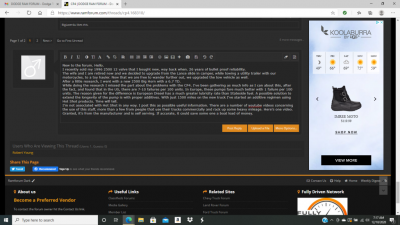

I recently sold my 1996 2500 12 valve, that I bought new, way back when. 26 years of bullet proof reliability.
The wife and I are retired now and we decided to upgrade from the Lance slide in camper, while towing a utility trailer with our motorcycles, to a toy hauler. Now that we are free to wander further out, we upgraded the tow vehicle as well.
After a little research, I went with a new 2500 Big Horn with a 6.7 TD.
While doing the research I missed the part about the problems with the CP4. I've been gathering as much info as I can about this, after the fact, and found that in the US, there are 7-10 failures per 100 units. In Europe, these pumps fare much better with 1 failure per 100 units. The reason given for the difference is, European Diesel has a much greater lubricity rate than Stateside fuel. A possible solution to extend the longevity of the pump is with proper additives. With just 1500 miles on the new truck I've started an additive regimen using Hot Shot products. Time will tell. If it works...it was cheap insurance.
I'm not associated with Hot Shot in any way. I post this as possible useful information. There are a number of youtube videos concerning the use of this stuff, more than a few from people that use their trucks commercially, and rack up some heavy mileage. Here's one video. A podcast actually. It's a half hour long but...be patient, it's packed with valuable info. Granted, it's from the manufacturer and is self serving. If accurate, it could save someone a boat load of money.
