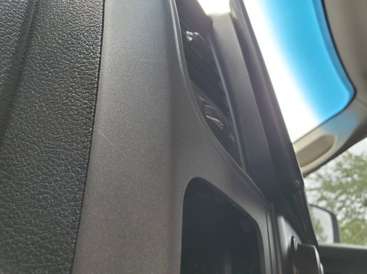

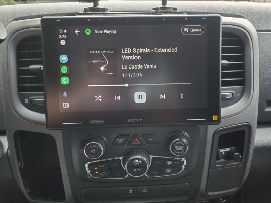

Here's some pics. The first couple are the unit head on and from the driver's perspective. The third is the side, looking at the form fitting adapter behind the Sony display. The last pic is same side, just from the driver's knee area to show the fit on the bottom.
FYI the hole in the dash is for my missing 8-speed shifter, it's stashed somewhere safe...where I can't find it. I'm still using the 6-speed with the column shifter. Just waiting for cool weather again to do the 8-speed swap!

Looks good Dave!
That's a very polished install from Prolific and good option for those that don't want to go with a factory 18-22 4c 8.4 AA/CP radio.
