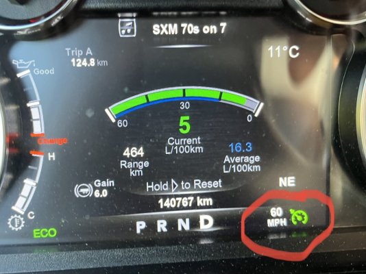

My cruise control suddenly reads in mph instead of kmh.
Ok changed the setting to US to get the psi reading on the tires like I have done numerous times then returned the sitting to metric but the cruise control now reads in mph, everything else is in metric?
I have tryed changing the settings several times but is still in mph.
Does anybody have a fix for this?

Only thing I can think of is disconnect the battery for a bit and then reconnect. Maybe that will reset it. Good luck.

On my 2016 Ram
when i have my speedometer reading out on the EVIC
i press the down button on the left side of the steering wheel, then i press the right arrow, then press the down arrow several times & i found that i could change from MPH or KMH

Thank you, I must have bumped the button and changed it to mph.
It’s now reading kmh
