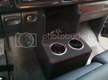

I'll try to draw something up next time I'm on a computer
Think of halo rings around the cup holders. You could make it look clean by routing the wire from the edge to the cup holder and cup holder to cup holder by routing it underneath.
Drill two small holes(maybe on an angle, I can't remember how well it bends) side by side, bring the wire up through one, around the ring and back down through the other hole

So iv come to the conclusion that I will def need to light it up in some way because tonight on the highway the cupholder worked great but I had to find it when I took my cup out lol it didnt help that its a dark highway, so not a problem in the city, but hey it would look pretty cool with lights so why the hell not :D When I go home in 2 weeks Ill get cracking on it.

ahh okay I gotch ya, yeah thats a good visual lol Ill have to see what I can do. Im wondering how I could attach it without taking away from the clean look of the carpet.

Depending on how tight the carpet is you could stitch it in with fishing line that way you wouldnt be able to really see it.
Maybe check into how people make the tron suits and stuff.
Last resort would just try a thin bead of glue, not sure if fabric glue would leave the blotches super glue would

The stuffs called elwire to, you might have better luck looking for it then glowire
I bet you could make it look really cool outlined with the lights, it's 2.3mm thick so you could use a 1/10" drill bit and weave inside of the box and route it to where you want to keep it clean

The inverter might buzz a little bit. They use a similar one as the ccfl lights I use for my frames, you wouldn't ve able to hear it if you hide it in your dash or somewhere else
I think road noise alone should be louder then the inverter
