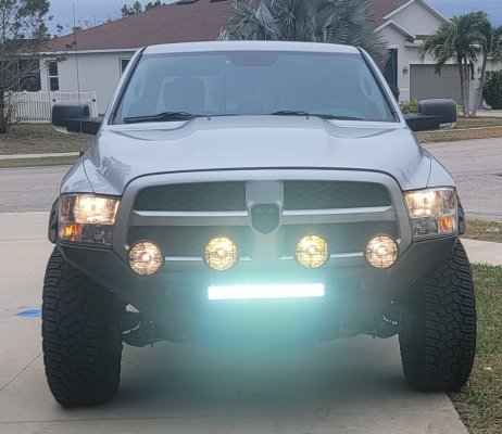

Spent my lunch hour messing with park sense. Initially the system wouldn't reset. But a couple key cycles and it was back up and running and detecting objects again. My theory was proven, so I'll wait on a new annular cutter and time to get things done. Not that I need it but I like having factory wiring and features in place.
Oh, and the center pair of lights are on the factory switch. I modified a pair of 280 Series Metri-pack connectors and connected to the factory harness just like plugging in the factory lights. It's not the right connector, but it's what I had on hand that could be made to work without cutting factory wiring. I like that retain all the factory functionality, auto on auto off, off with high beams. Though auto off with high beams may get changed with Alpha here shortly.
And damn is that LED bright and blue...

What is that LED light??

It came with the bumper. Some 20 inch unit. I did expect much but it's effective at night for sure.

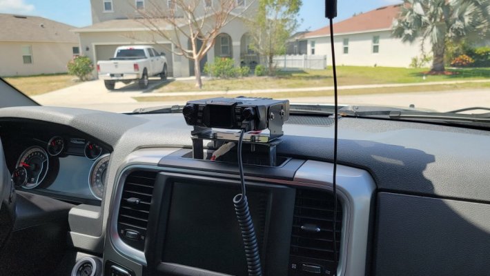

V1 of the GMRS mount I tacked together. Next incarnation will be about an inch shorter and likely canted towards the driver side.
Motorola GMRS antenna on a valley radio mount. Have a 3 foot whip on the way for trips outside my local area.

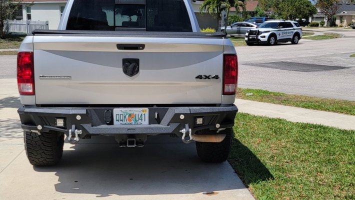

And finally got the rear parking sensors drilled and mounted. I have to extend the harness across the center so that will most likely happen in the next week or two. But that means the d rings have to come back off as the interfere with the signal.
Reactions: j-b

Hot damn parksense is working in the rear now. Nice little lunch break task to wrap up. Took about two minutes for the truck to recognize everything was in place again. Was worry for a bit when I started her up and nothing but service parksense was on the screen. But it works. Yay.

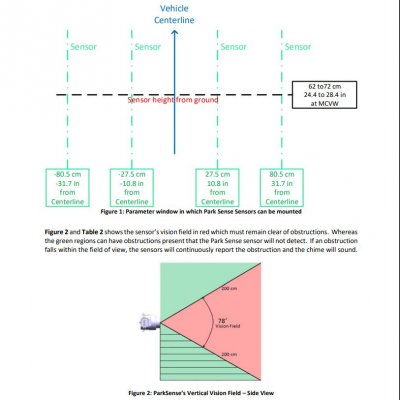

I had a PM about parksense, for retro fit in to aftermarket bumpers, this is the important information.
Reactions: j-b

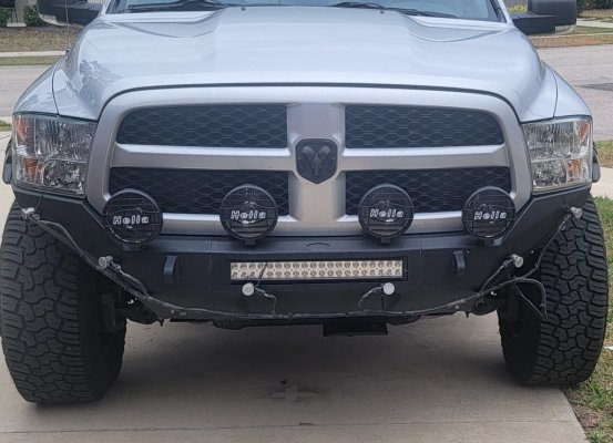

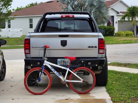

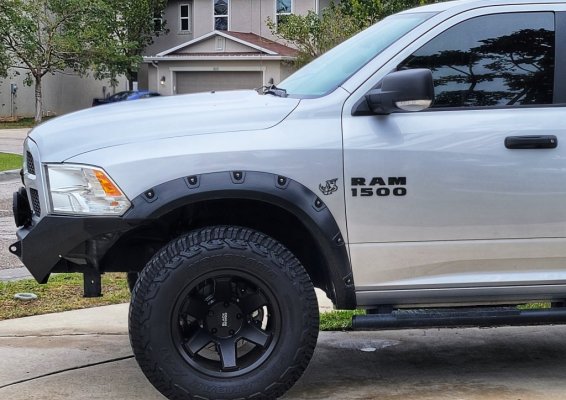

Hahaha. Front park sense sensors are in and functional. Good to have it all back in. Had to change my placement from the original plan due to bumper strcture issues.
Rambar is on. Sits a bit proud and I need to figure that out sometime. But for now it's ok. Looks good from a far but far from good looking. J/K either way I love it.
Fairly eventful day for me.
