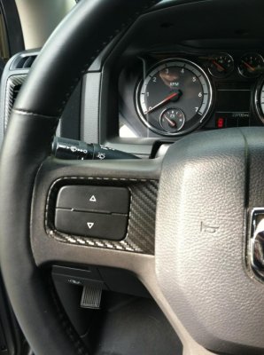

3M Carbon Fiber vinyl wrap. Very very easy to apply and easy to remove if you mess up or don't want it anymore. I also did the chrome trim piece around shifter console. Will be painting silver sections gun metal and trim the air vents in carbon to match the others. The roll of vinyl was $40 on ebay for a 60"x24" roll.

There are youtube video's on taking off all the interior trim its pretty easy... all the vents are just clips as see in the above pics. The whole center but the radio has a few screws and then just pops off... there are 2 in the tray up top that says dodge, 1 underneath the outlet port over which that cover just pry's right off from the bottom you'll see the notch... then there are 2 screws in the lower front tray in front of the shifter below the radio.... bezel around shifter pops right off and all should from there pop right out.... any other problems you can find on youtube but its pretty straight forward
blackout11
May 23, 2011
4,000
453
alpharetts GA
2011 R/T
And as far as the steering wheel pieces they just pry out be careful
And the vents on the right and left side of truck just insert finger inside (above vents) and pull they come right out
