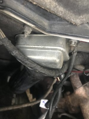

there is also a silver box mounted to the firewall that has several wires going different directions one going to the alternator (looks like it was added by a previous owner)maybe a type of regulator or something

This is what is mounted to the firewall the goes to the alternator as well as several other places just not sure if its a type of regulator possibly hooked up wrong or maybe not at all

I figured it was indeed a regulator and i rewired it and added a ground between the alternator and the regulator but no change so I ordered a new regulator and im waiting on it

The new regulator fixed the over charging and the battery gauge on the cluster works about half the time and the other half its on zero any suggestions? Is there a sensor somewhere for the battery voltage
