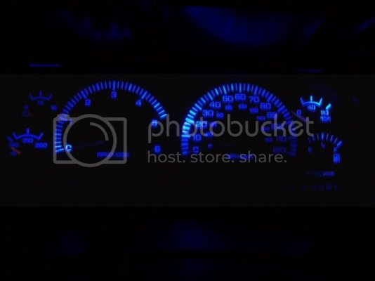

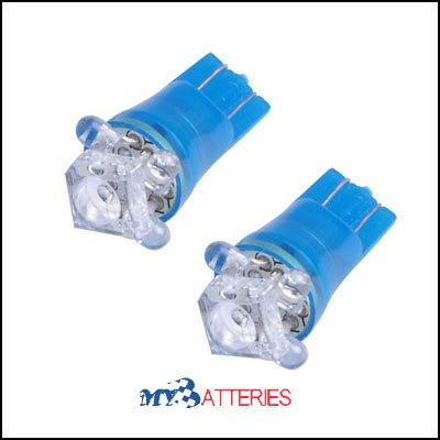

Got my new LED's in so I redid my gauge cluster. Going from ones with 4 leds to 5. 4 of them out the side with a high power on top, I have alot better spread now, and less hot spots.
Before (4 bulbs)

Looks good, but it looks like you got a couple of 'hot spots.' I don't know how much of a pain it would be, but maybe you could put the four led ones back in to fix the areas at the 0 on the tach, 20 on the speedo, and 110 on the oil pressure?

Thats where all the bulbs are located.
I think it shows more in the photos than actually in person. And I think a couple of them are not even on as they need to be turned the other way, so that may will help spread it out more too.
