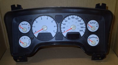

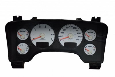

The cluster itself will fit into the dash, externally they are the same. If you are transferring all the 03 wiring then it will plug right in. Don't plug the 03 cluster into 06 wiring. For reference:
