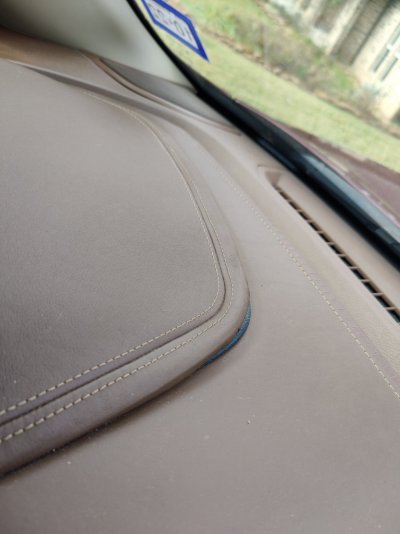

I am now having the same problem.
The passenger side is bubbling in the curved corner and the piece on top of my main dashboard(behind the steering wheel) has shrunk and popped our of place.
I have a Mopar 3/45 PRE-OWNED MAXIMUM CARE • 3/45 CUSTOMER CONVENIENCE PACKAGE UPGRADE I currently have 70k miles. and my dealer is saying that the interior is not covered in the extended warranty. I will be dropping it off Monday for another service item(washer fluid tank is leaking) and they will quote me on this.
