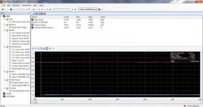

Can someone tell me where to find the mph in the datalog. I have done 8 datalogs and spent hours reviewing them and cant find a PID for mph anywhere???? I have a 2013 Ram and DCX tuner.

Here is a screen shot of my data log. No vehicle speed???
It has to be selected as a pid in your tuner to record the data. How to select it depends on what tuner you have. Check your user manual. Your user manual is on the diablosport drive when it is plugged into your computer. You can only select a limited number of pid's on the intune because of memory limitations. If you want to use all pid's I suggest you live data stream to your laptop if you have one.

Ok. I'll check for it again in the PIDs. Didn't see it last time.
