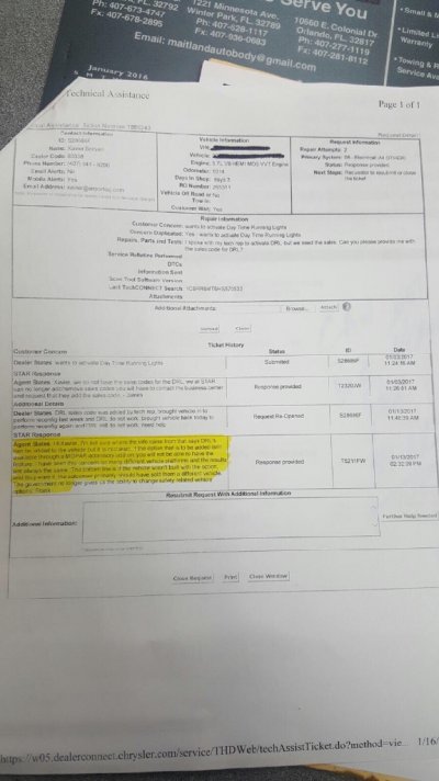

Yes, if the code is in the system. Those instructions are 100% useless if the code is not in the system. There is nothing the dealer can do directly at this point.
This photo was posted by a member here. They didn't have the code available but were able to get corporate to add it to the system. Even then, it didn't work properly once added to the truck. When they tried to escalate the issue, they were flat out told by STAR (the FCA internal dealer technical support organization) that they were SOL. There is more to this than a lot of people realize and it goes much higher than the dealer. For many people, bringing along that printout or going to a different dealer is going to do them no good.
Until FCA decides to officially support DRLs as a dealer installed option for RAMs across the board (like they should have done years ago) this is going to continue to be an issue for people.
