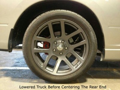

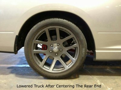

while you're at it you might want to take a look at the alignment of the wheel in the wheel well from a front to back perspective, youll most likely need adjustable control arms too.
these image are borrowed from the spohn website
Sent from my SGH-I317M using Tapatalk

Lol, I know that truck! We were both talking to Spohn when he originally got that done, saved me having to do the measurements.
As for the rear-end 'waggle' the alignment is very key. At speed, a very minor angle in the line of thrust can cause issues, that's where the full set of adjustable bars comes in handy, you can dial it in perfectly for the ride height. Also, find out what your front caster angle is, if they set it back to factory spec you're now actually sitting more positive relative to the factory spec which can cause issues at higher speeds. For high speed driving a negative caster is better than a zero caster angle.
