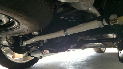

20180623_095150.jpg I have the same problem 2018 scsb ram 1500 2wd even at 65 if i hit a bump the ass end wobbles like a drunk fat ******* high heels called belltech and was told i need control arm relocating brakets,a bigger sway bar and pan hard bar great another 1200 in parts if i do the work myself

Yes you need atleast the Illicit no cut brackets. These trucks arent cheap or easy to lower the correct way

I have a rear shimmy when going over a particular large bump at 60. I installed the hellwig rear bar and it works great.

The adjustable panhard bar and bracket is one of the key components when lowering our trucks. Another key component is the Illicit Customs no-cut rear brackets. (Moe's has them on sale) They help put the rear end suspension geometry close to factory settings....pinion angle and center wheels to bed.
