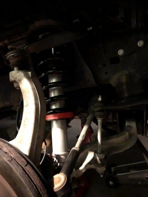

13E1D2BF-2B5A-4E9A-AF4F-4C2051494592.jpeg So the new struts and shocks are on the truck and it’s still doing it. Feels slightly better, but still shakes and vibrates. All the bushings are fine. Nothing worn that I saw. Back to the drawing board.

That behavior (video) looks like insufficient toe-in. When the front end was checked, it might possibly be the case that the truck was not shaken down to resting and the lead edges of the tires forced apart before taking the toe reading. That part is somewhat irrelevant, though. The front end appears to be walking a little bit, that is, switching steering from one wheel to the other and back again. Increasing the toe-in to the high limit would prove/disprove it. If it improves, but doesn't eliminate it, I've seen vehicles that have to be set at slightly more toe-in than the spec high limit to make it quit.
Why does it look like the ball joint stud is exposed above the knuckle?

I didn’t have anything tightened before i took the pic. But what you are talking about, it Sounds like I would have to take it to a shop to have this corrected. Correct?

I'd take it to a shop and see if someone would go for a ride with you to see what the truck does. Ask if they'd be willing to adjust the toe once or twice to see if that corrects it and for how much $, including putting it back to where it was if it doesn't fix it if the following applies: If the truck has been doing this for a considerable time, I would look for evidence of slight toe-out. That would mean that if you placed your flat hand across the tire tread, fingers pointing toward the opposite wheel, and slid your hand lightly over the tread, you would feel a slight knife-edge as you slid it toward the opposite tire and smoother as you slid it back. If that's what it feels like, it's worth going to a shop.
