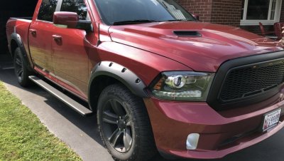

I have a 2015 1500 sport 4x4 and recently when I hit a pothole or bump in the road my steering wheel goes crazy! Is this the death wobble? What can I do to fix it?! I have about 95,000 miles. Mechanic said there was nothing wrong with it and everything was tight. Any ideas? Id upload the video I took this morning but it says it’s too large of a file. Thanks!
