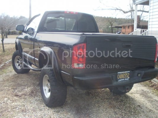

ok i debadged the truck and did a quick clean on it. Any ideas on how to get the outline of the badges to go away? And aslo i was thinkin about removing the door spears should i leave them or take them off?

Looks good man! You should wet sand and buff the areas that have outlining and that should take it off.

truck looks great! love them black rams.

i just did mine too and was wondering whats the steps to wet sanding and all that?

Yeah hit that up with a clay bar and maybe some rubbing compound, if that dont work then go to the wetsanding.
And leave the door-spears, they compliment the fender flares.
And I dont know if Ive ever seen pictures of your truck before but I like it! Im digging the lifted reg cab, now paint those wheels black!

well if i leave the spears then i have to repaint them the passenger side is starting to peel.
As for the wheels i have to get new tires anyway so i am saving to get sone wheels and tires
