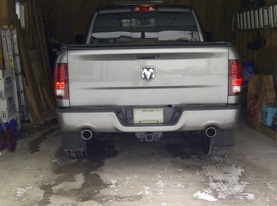

Finally debadged. I must say I really like this look much better than those huge badges. :happy3:

I have a R/ T and she looks a lot better naked! Pull those badges off man!
