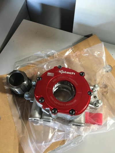

I have one on the list for when the headers and exhaust go on my hemi but this is what went on my LS7 2 months ago IMG_2879.jpegIMG_2892.jpeg

The 5.7 doesn't benefit enough from an upgraded pump to justify the cost Dan.The 6.4's with the piston squirters which are a built in leak see a bigger benefit from the upgraded pumps then the 5.7's so. You're better off upping the idle.
