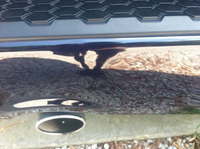

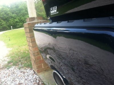

Don't know how well these still pics will show it, but it sticks out like a sore thumb while doing a walk by. The most obvious spot that shows up in the pictures is at the top where the edge rolls over. The full dent extends three inches below that point. Notice how the reflections are all wonky. This is what you get if you don't know what your doing. ImageUploadedByTapatalk1432151381.341621.jpgImageUploadedByTapatalk1432151392.738187.jpgImageUploadedByTapatalk1432151404.401980.jpg
