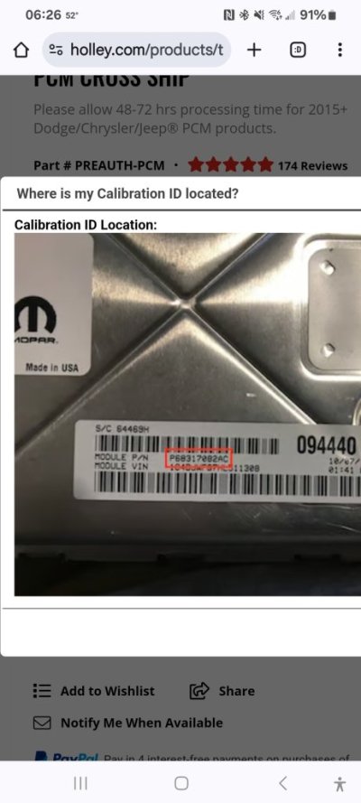

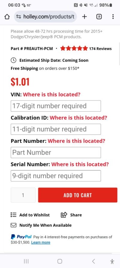

Here's a screenshot from the Holley site. Tech told me to use the original part number for calibration id.

the 303AB is the actual part number. The "Module part number" is the one that has the software configuration .
Diablo wants both those numbers on the form. Did on mine, any way.
In reality, they only really care about the 303AB, as it the correct / compatible hardware inside the module. They jam the updated software into them all.
I think this is what the tech was saying too. The tuner will download and load calibration updates as necessary. If it determines the truck calibration is too old it will trigger a download. When I connected my i3 to my truck it said not compatible and then I went in and connected to Wi-Fi and had a calibration update. It's weird that my tuner and alfaobd and torque pro all pull a different calibration id then what's on the stickers. Wonder if it had another update and just never got a sticker. I bought my 2017 in Jan 2022 and am the 2nd owner. I'm assuming the original owner had it in for service under warranty a few times.
