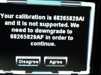

diablo cal issue.jpg I have a question ya all..........Took the tune out of my truck for the winter but left me ecu in it....Over the winter my truck got hit in a parkin lot..So it went in to be repaired and the dealer did some updates and im now just realizeing i left the diablo ecu in it...........
Went to put my tune back in and and my tuner is saying my cal needs to be down graded to a (bunch of #'s) from ai to and af(last two letters on the tuner)..
Before i start freakin is there anything gonna be locked out via dealer??
Not tried to do anything yet,about to hook up my tuner to pc here shortly..OK..went out after tool update and tried again..same thing..Heres a pic of the screen..

My ecu and tuner was fine before..I updated the tuner to where it needed to be but now it will not write to ecu now..Goes through all the steps and acts as if its sending to ecu then i get the msg "pcm error write failed(-1)....I continue and screen says The tune was not put in the vehicle...Finally the factory tune get re installed..
Acts like there is a road block writeing to pcm...
Been contacted by diablo(rich),workin on it..
Gettin a vibe that the dealer has a lock of sorts on it..My thinkin is that ill end up sending my pcu to diablo for a reflash..$100+ i dont really wanna spend rite now..

What ended up happening? I had to get code from dealer for access
