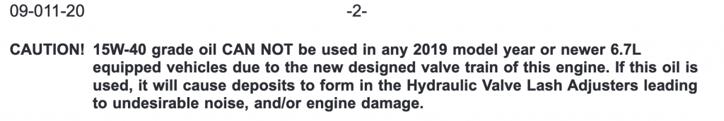

Are you using 15w40 in your 2022, it calls for 10w30 and 5w40 synthetic can be used...

yes i use 15w40. i know what the recommendation is but where i live it is not below freezing much and my truck runs at 190deg on a cool day. My secretary husband is a ram/jeep/fiat master mechanic he said they came out with that for people in really cold environment and better fuel economy crap.

Your truck, your money, but the warning is not temperature related.

So that's why they went to 10W-30. Hydraulic valve lash lifters. I wonder how much wear they sacrificed for this downrate in viscosity not to have to adjust solid lifters?

Yes, the new CGI engines have hydraulic lifters, a hollow camshaft, a scissor gear on the cam drive, and the water pump and other ancillary items are now aluminum instead of iron.
