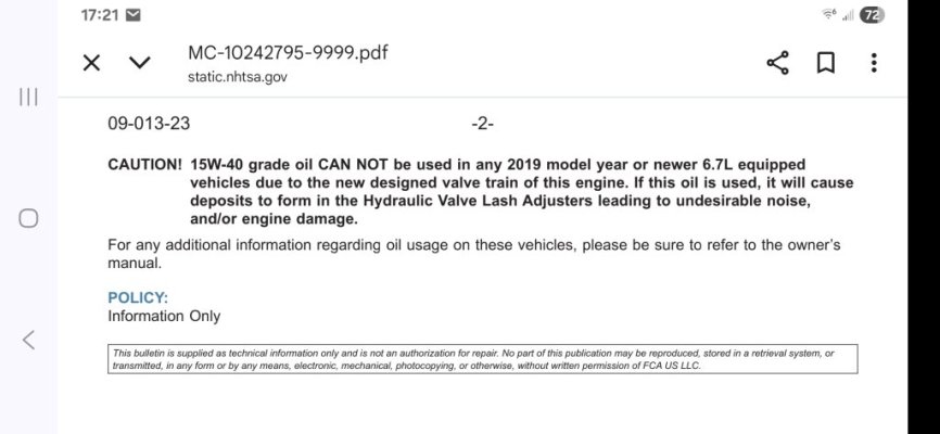

You can NOT use 15W40 in the 2019+ Cummins with hydraulic lifters.
5W40 can be used year round and in all climates, hot or cold.
