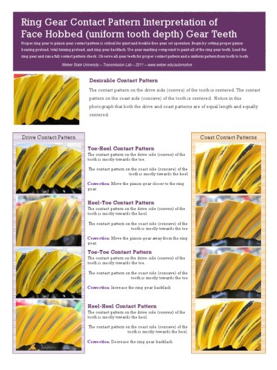

That's a horrible pattern. Your pininon is to close. You can't just add a Limited slip without pulling the pinion.
Always run a pattern before dissembly , that way you know what you're working with. Factory patterns are dog **** most of the time.
I Always use Yukon gears and never had any whining.

New ring gear and old pinion usually don't mix worth a crap,as the pinion already has a wear pattern that matches the old ring gear.
I totally agree here. Installing a new ring gear on an old pinion gear with an established wear pattern is a recipe for a gear whine. You're lucky it's only on the coast side.
I also think you should re-do your wear pattern and check your backlash with a proper dial indicator.
