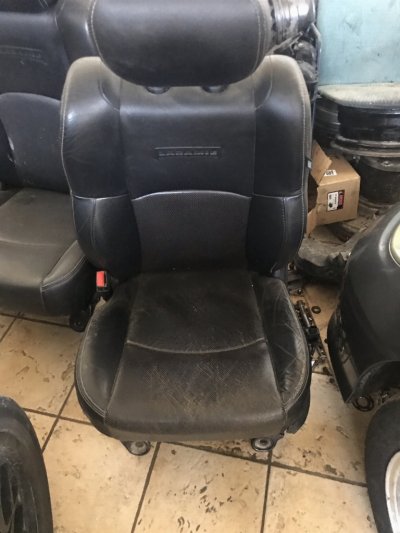

Ok I found a set off a 2015 but the center console is the one with a shift knob not a jump seat.
Can I do the following: use the two 2015 Laramie seats (very comfortable) with my current gen 3 jump seat?
I know I’d have to reupholster my jump seat to match the new 2015?seats.
Just trying to make something work because I think I can get the seats really cheap.

Those look awful, I hope it's just the camera or that they're dirty....no you can't use your 3rd gen jump seat with those because your jump seat mounts to your seat frames (you really need to take a look under there). Those particular 4th gen seats don't have that capability. If you look closely at the pic, you can see the supports coming from the bottoms of the seats for the jump seat. The seats you found are strictly for console. You can still mount the console (if you're willing to cut up your dash lol) and get the empty insert (stop obsessing about the knob, the knob is on the dashboard itself).
