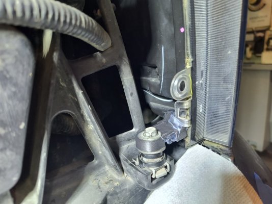

dang, wrong set of tabs -- forgot about that bracket
this is the one i was referring to

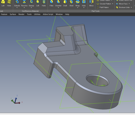

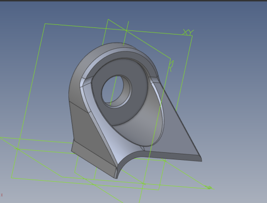

Oh, yea, i already have those. I'm in the process of designing some now, and over the next few days.
I'm trying to design something than can be epoxied on that will be as strong or stronger than the original. When I finish, ill post up the stl file for ya.

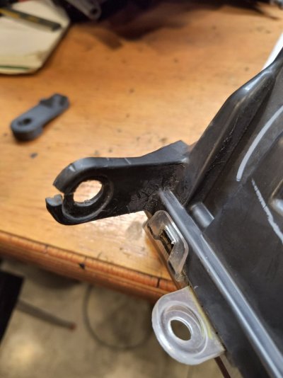

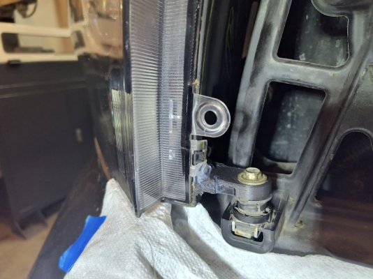

The way eBay replacements are broken, one still has a stump, and the other has a split at the hole.
For the one with the stump, I made one that will epoxy to the existing stump. The stump had a big crack in the plastic near the root/housing, which I repaired using a soldering iron and some ABS filament to weld in the crack.
Like this:

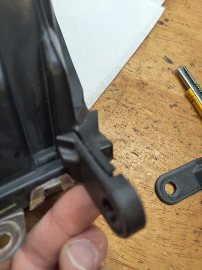

Here I the printed tab:
The other side has a complete tab, it's just split at the hole i could either cut it shorter, like the first one and mirror the last 3d printed part,
Or leave it as is and use a version designed to overlap the existing tab. Like this:
I'm not sure which way to go. Thoughts?
Either way, I still need to modify the 3d model for a little better fit. I'll work on it a little more this evening when I get home.

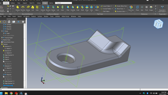

I think I'll cut the 2nd tabs bolt hole off, and leave a stump the same as the first one. Then I can use a mirrored version of the first part, for the 2nd light.
And add a vertical locating tab on each side, to add some more contact area for epoxy and to help with positioning.
As long as it doesn't interfere with any other grill or truck parts, which I won't know until Sunday when I get time to try it on the truck.

I mounted the headlights, adjusted them and snugged the screws while the epoxy is still wet. Using only the top screen to hold it, then positioned and epoxied the new lower tab. Hopefully it results in a stress free setup, with nothing pushing, pulling, torquing or twisting against the epoxied parts.
Oddly, the replacements have different color
LEDs. They are OEM, but from a later year (2016), where mine is a 2013. My 2013 had very Amber LEDs, these are alot more yellow.

I made a solid, closed in version for anyone has a headlight with the lower tab completely missing, with no stump to epoxy the other version onto.
To get it positioned and aligned, the headlight should probably be mounted and adjusted. Then, the epoxy added to the lower tab, the tab postioned and the screw installed and snugged down. That way you don't end up gluing it in the wrong spot and having to cut it off and start over.
You can download the files here, along with all of my other 3d printable CAD designs.
