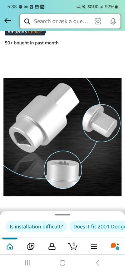

Crap I threw the dash back in same day without doing the evaporator. I'll try to get the coupling out for a picture, it's not quite the gear shape like that amazon post but thank you!

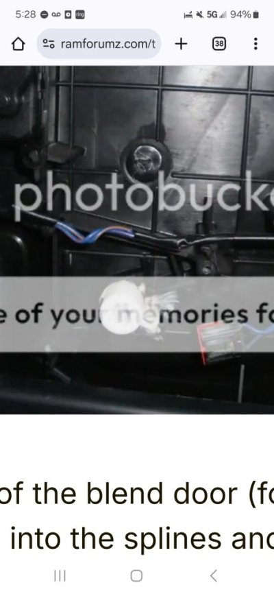

Best I could find quickly here. The part looks just like the amazon link but the 2009 has a spline end. The blurry screenshot from another post shows the white part im referring too.

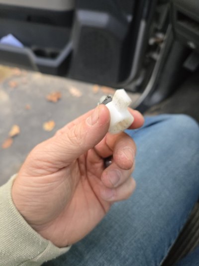

If this helps anyone in the future this is the part I was discussing. Local dealer could not find it
