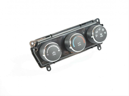

Which HVAC Control Head is your truck equipped with?
Manual Temp Control
Or
Automatic Temperature Control?

What exactly is the problem with the control head?
Is the control head completely inoperable?
Have you checked to see if the K17 recall applies to your truck? Give your local dealer a call and speak with a service advisor. Give them the last 8 digits of the VIN and ask them to see if the K17 recall applies to the truck.
If it doesn't apply to the truck...is this your control head?

The recall does apply, but the recall work was done in 2010, and Dodge is saying they won’t cover it again. That is what the control head looks like. But it’s the control module that’s crapped out.
