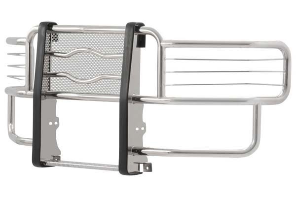

This is what I use. Cheaper than a full-frontal collision with a deer. Might still ge some damage but it sure helps.luverne-311033-321332.jpg

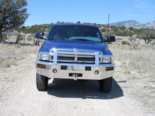

Push bumpers are just that, a way to gently push something off the road. PIT bumpers are more robust, but still not built for ramming anything. Trucks are just harder to protect. Sitting up higher means you hit the deer in the body instead of taking it's legs out from under it and the brick shape of the front end means it absorbs the crash instead of throwing the deer.
A grill guard may be helpful in a very low speed strike, or a clip, but I think you'd need a for real armored bumper for damage free deer strikes at speed.
Also keep in mind airbag compatability.
But in lower vehicles the animal is often lifted and launched into the windshield or over the top of the vehicle.
