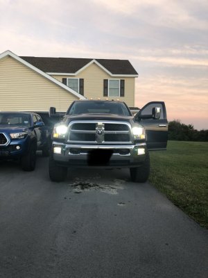

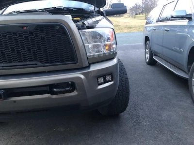

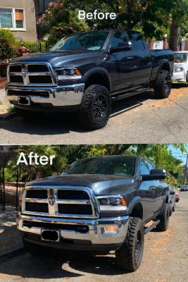

Huge thank you to @Mpgrimm2 for making a harness jumper for my 2013 2500 tradesman.
I wanted fog lights but didn't want to run a toggle switch. Now I have the clean factory look I was going for!cummins2.jpg cummins3.jpg

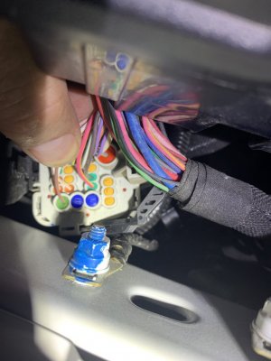

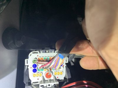

IMG_2519.JPG IMG_2520.JPG Hi. I have 2019 ram 2500 6.7 cummins. My conector looks different. I attached pictures. Do you think I can do View attachment 209361 installation of the fog lights? Where should the 2 pins connect? Thanks.

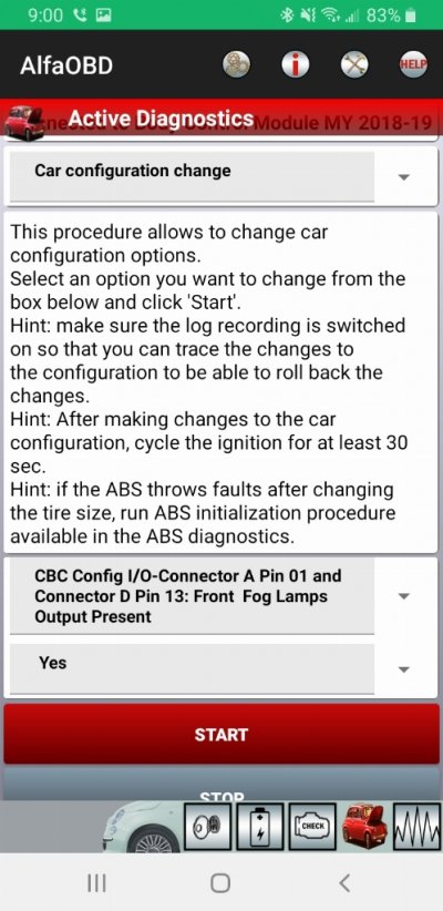

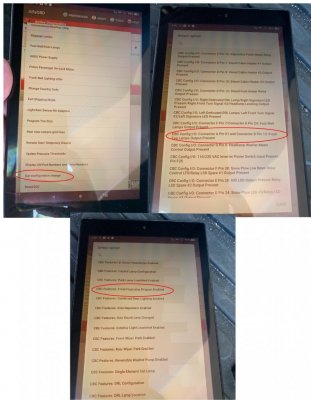

Programming with AlfaOBD
( thanks @1500ram12) ...
Reference:
** AlfaOBD
(for activating factory features yourself. See docs linked in OP)
WARNING:
If you have the AlfaOBD tool, and want to try this (vs dealer activation), please read the AlfaOBD thread OP and enable data logging before you start.
None of the people that have used it for activating the fogslights on their own have had a problem, but proceed at your own risk!
AGAIN: Do this at your own risk. I am not responsible for anything that may happen to your truck as a result from performing these steps.
- Connect to your model year BCM (2018 & 19 classic still use the MY16-17 powerNet for now)...
- Select ... "Car Configuration Change"
Enable Foglights:
>> Select ... "Front Fog Lamps Output Present" = select "YES"
*This is actually the 'Ecu Config 01 - CBC Configurable Inputs/Outputs' section.
6/15/20 Update:
Looks like Alexei changed the menus around for enabling the Front Fog Lights... Used to be directly under the car configuration change menu but now you have to go down to the ...
CBC Config I/O - Connector A PIN 01 and Connector D PIN 13: Front Fog Lamps Output Present = YES
Fogs ON with high beams:
>> Select ... "Front Fog Lamp Dropout Enable" = select NO
* This is actually the "Ecu Config 02 - CBC Features" section.

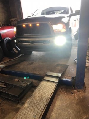

For weeks I was trying to get my fog lights working and know they are on and functioning after install from scratch.

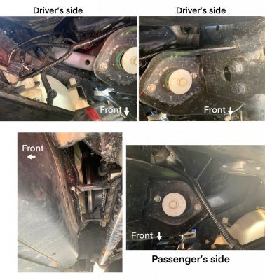

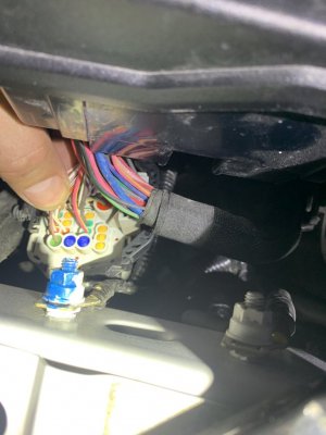

Just finished my fog light install, thanks again to @Mpgrimm2 ! I did the install on a 2018 Ram 2500 Cummins and thought I’d add some photos of how I routed the wires around the inner cooler / bumper / frame. Also included photos from Alfaodb of how to enable the fog lights and how to turn off the high beam dropout.
