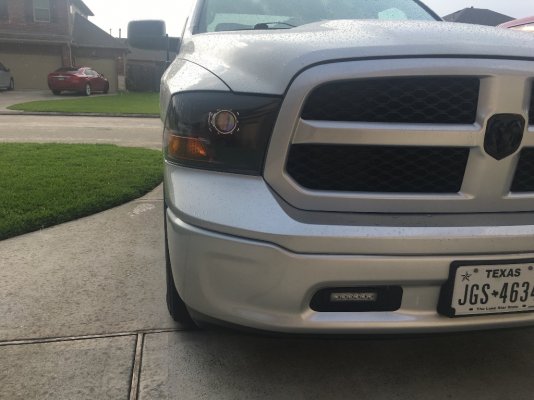

and some night shots ...

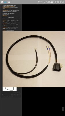

Old thread, I know, but the only one I've found that shows the "extension" harness I need. Are you still building these to fit a 17 3500 Ram? If so, I'm looking for one....Screenshot_20180827-122932.jpg
