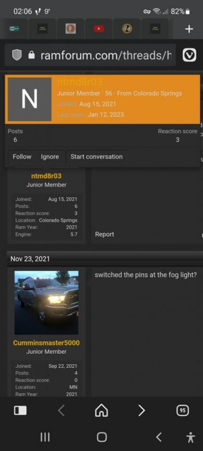

Hey
Will you sent me where did you buy your fog light I have 2021 ram warlock please and thank you and what is the parts do I need and also if you have a video how to install it so much helpful thank you
FYI, the OP'er hasn't been online in about 9 months.
