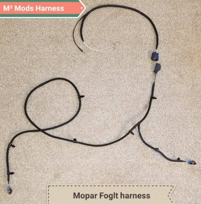

I have a 2011 Ram 2500 that I am installing fog lights on, I have a new bumper stock fog lights for 4th gen and the light switch for the dashboard, I guess the only thing I can't find is the connector from the tipm, is this the connector that you make?
Mpgrimm2
Mpgrimm2
Supporting Vendor Navy Badge
Mar 30, 2014
6,587
5,202
SC
2022 Ram 1500 (5th Gen)
5.7L
Yep. Message sent

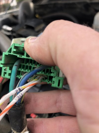

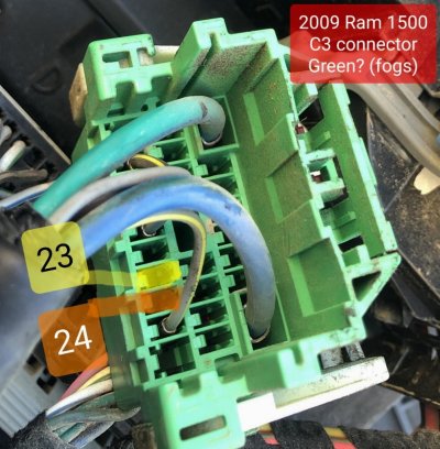

The connection on my 09’ Ram 1500 is just labeled C and it is the Green with red face plug. The proper pins are still 23-24, which are right next to the gray and yellow wire in the picture. My fogs have DRL and I just tapped into the DRL wire of my lights.

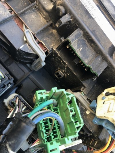

I tested everything and will be doing the bumper and placing the fogs in hopefully tomorrow. More pics to come but here is the under of my TIPM and the connections. Don’t mind the dust and spiderwebs :)

Thanks for sharing BigRam1411 !
I'm surprised your 2009 1500 C3 labeled connector was GREEN vs Blue that is listed on the connector sheet? Glad you checked the actual label/imprint on the TIPM. Just goes to show that you can't always trust the official documentation.
> Does your 09 TIPM layout & connectors look like the 2011/12 version in above posts?
> Does this look correct for where you installed the foglight pins on your C3 connector?9c5cc31b395da8fb1d53e364e1971e1f.jpg
M² Mods.
Yup here it is installed.

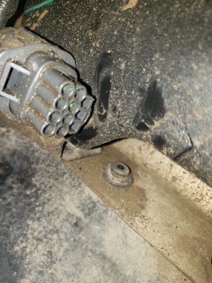

20210504_180914.jpg I have a 2018 Ram 2500 Tradesman. Is this a factory fog light plug behind the bumper on the drivers side?
tron67j
Oct 14, 2019
4,105
5,425
Maryland
View attachment 246372 I have a 2018 Ram 2500 Tradesman. Is this a factory fog light plug behind the bumper on the drivers side?
I have same truck. I installed factory switch with fog light, then you run M2Mod's harness from under the external fuse box to then connect to your fog light harness (which I ordered the factory harness). Then you plug your fog lights into that and use AlphaOBD to enable the fog light operation.
