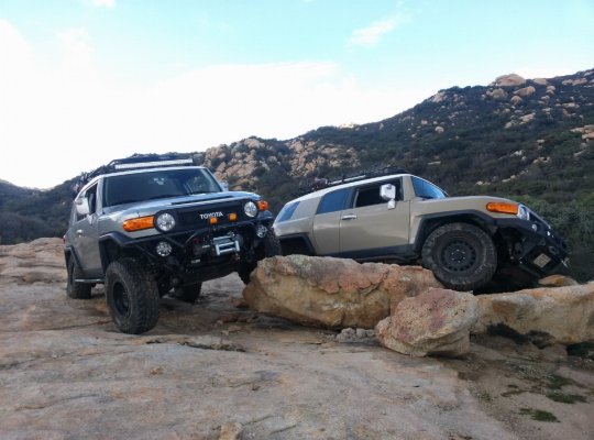

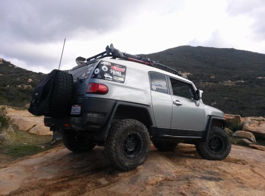

Having good times and phucker factor with IFS is 10 times more intense :)
16415410785_bad573b1b3_h.jpgCAM02492 by RAM RSM, on Flickr
15792917934_d83c1db66d_h.jpgCAM02490 by RAM RSM, on Flickr
16246016980_74609f19f8_z.jpgattachment1 by RAM RSM, on Flickr
16433422515_a6c5aea73e_b.jpg_DSC3405_zps1369330b by RAM RSM, on Flickr
Something about those FJs man, I still want one! 3 wiper blades ftw!!

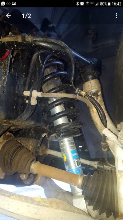

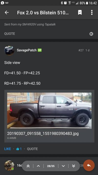

Just a few more updates I recieved from the guy on the other forum running this as well as his fender measurements on 315s. Tho the angles aren't terrible, surprisingly, it's something to be mindful of and keep and eye on the boots on the cvs and steering up front. Might experience a bit of bumpsteer as well, but it's hard to say.
If you're looking for an aesthetic lift kit, this obviously works, just realize it's a compromise and won't withstand abuse like either a drop bracket lift or a level plus a body lift. I can't knock what I haven't run, and the guy in chatting with obviously uses it, but just be vigilant with maintenance. Different stroke for different folks. 5b29aadf8a8e411fcdc72a03eb06c4ba.jpged6ea4c3f6d5e66e7f5176537f055075.jpg28dae1f393cdf53b7f1f97fe125c6b06.jpg792f4015abc23f01c43882fbf5eb9e34.jpg
