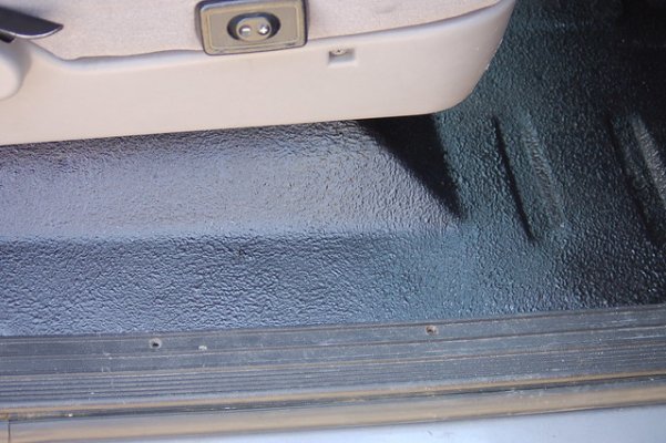

I can tell you from Experience Mosta-Liner is very good. It is activated with a mix that makes it cures when you roll it on. Makes a better bond then other DYI that aren't activated. I think yours is activated as well, which is good. The texture comes from the roller, not rubber chunks. Makes a much better bed liner, wont flake. I say LineX is a ten, Monsta is very good quality at about an 8 in comparison to LineX, Their comparisons to other DYI here.

I've done a few of them easy as can be. I do all my prep one night usually over a few beers and spray the next day the reason I don't prep and spray the same day is to remove any temptation to cut corners I'm out there for a few hours with the da and a scotchbrite I'm not going to gain anything by not running that scotchbrite more and more until im sure I got it all a quick wipe down with some solvent and it's good to go
nationalminer84
Apr 15, 2015
165
38
After spraying that product I'll never go back to roll on. It's the exact same quality job you get from some professionals (linex is sprayed heated out of a specialized machine hence their unique texture) but some of the other liners? The same process and results
