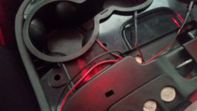

First thing I did was remove the rubber cup holders and drill a small hole, just off center and towards the rear of the cup holders and run the disk wires through them. The disks sit flat, and are held to the cup holders with double sided tape. 1st pic. Reinsert the cup holders
I then tied all 3 positive and negative wires of the disks together, using a shrink wrap butt splice, and a cap screw (all I had on hand, and will replace the cap screw with a butt splice when I get a chance to pic some up) pic 2

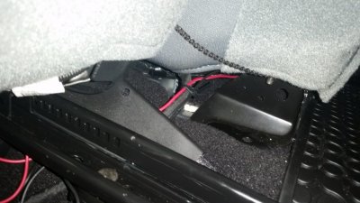

So onto Plan C... get power from under the drivers seat...success! There are 3 harnesses under the drivers seat, the one that controls the 12V is the one with only 2 wires coming out of the back, the wires were black and purple. Simply push down and wiggle the harness til it frees from the the bracket it's attached to, for easier access. I don't have power or heated seats, I'm sure that's the harness used if you did, so I would take note of where the black and purple wires are if you do have them. Pic 3
I had a few feet of red and black 12G wire sitting around, and found a couple of butt spices in my tool box ...I'm sure the easy way to go would be to use some quick splices, but I didn't have any on hand. So I peeled back the tape, cut the wires and used the butt splices and connected them to the 12G wires. Pic 4

After that I ran the wires under the seat , to the drivers side pillar of the counsel. Ran the wire up and behind the fabric and up the pillar. pic 1 and 2.

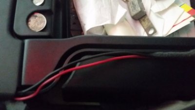

Went down the cover and under the little pocket of the counsel fabric on the drivers side. Peeled the fabric just a little bit and ran the wires down the little track there. To the little bend in the counsel Pic 3 and 4.
I tied the 12G wires into the butt splice and cap screw (so cheesy I know) then just tucked the connection and extra wire into a little opening to the left of where the bezel reconnects, so the bezel would sit flat. Pic 5
