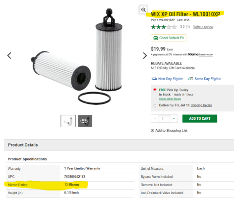

Thanks. I've seen that add. It's the only one that states 13 microns I've found. You would think Wix would put that on their website if that is actually the real number for that particular filter.
Everyone wants to tout 99% efficiency. That number means nothing if 99% is when filtering pebbles.
It's like the Fram 99%, then you finally find out it's "greater that 20 microns". How much greater? 25%, 35%?

OK. I just got off the phone with WIX in Gastonia, NC.
They are telling me, and I had them confirm this twice, that synthetic filters have an approximate 35 micron rating. The high micron rating is what gives a faster/better oil flow on synthetics.
The cellulous filters have a micron rating of approximately 21/23 microns, and filter smaller particles better than synthetic media.
This was from the product support department directly.
They didn't know why Oreilly's had 13 microns on their website, and that it was wrong.
I guess higher micron ratings with synthetics is why Fram is vague when they state their efficiency is 99% above 20 microns. They just don't tell how far above 20 microns.

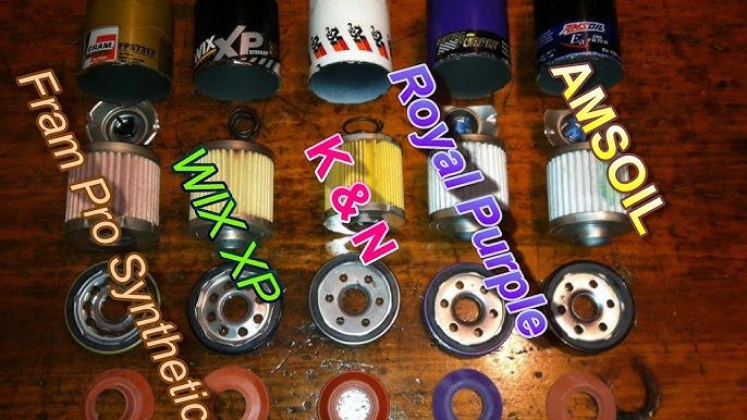

The starting % of wix is not accurate, the media is so thin when an oil pump starts pushing fluid through it they become nothing better then a rock catcher. Look at the media.. Every wix xp I have seen, and I have seen a few, all the same, super tight thin media. See results on the bottom tested by a oil filter testing company. That company has no horse in the race.

If that 2021 chart is still relevant to 2025 filters, especially since Fram has started building their filters outside the country, with the Fram Ultra cartridge filter for the Pentastar made in China, I guess I will run the one China Ultra I have left, and the older Fram synthetic blend sitting with the Ultra.

That is a test of the exact numbers, if you want you can test those numbers against what wix said their specs were at that time. You will find wix numbers are not even in the ball park of reality due to what I was saying.

There’s been a few more YouTube filtration reviews since the one Burla posted was done. All similar results. I use the fram xg11665 filter.
